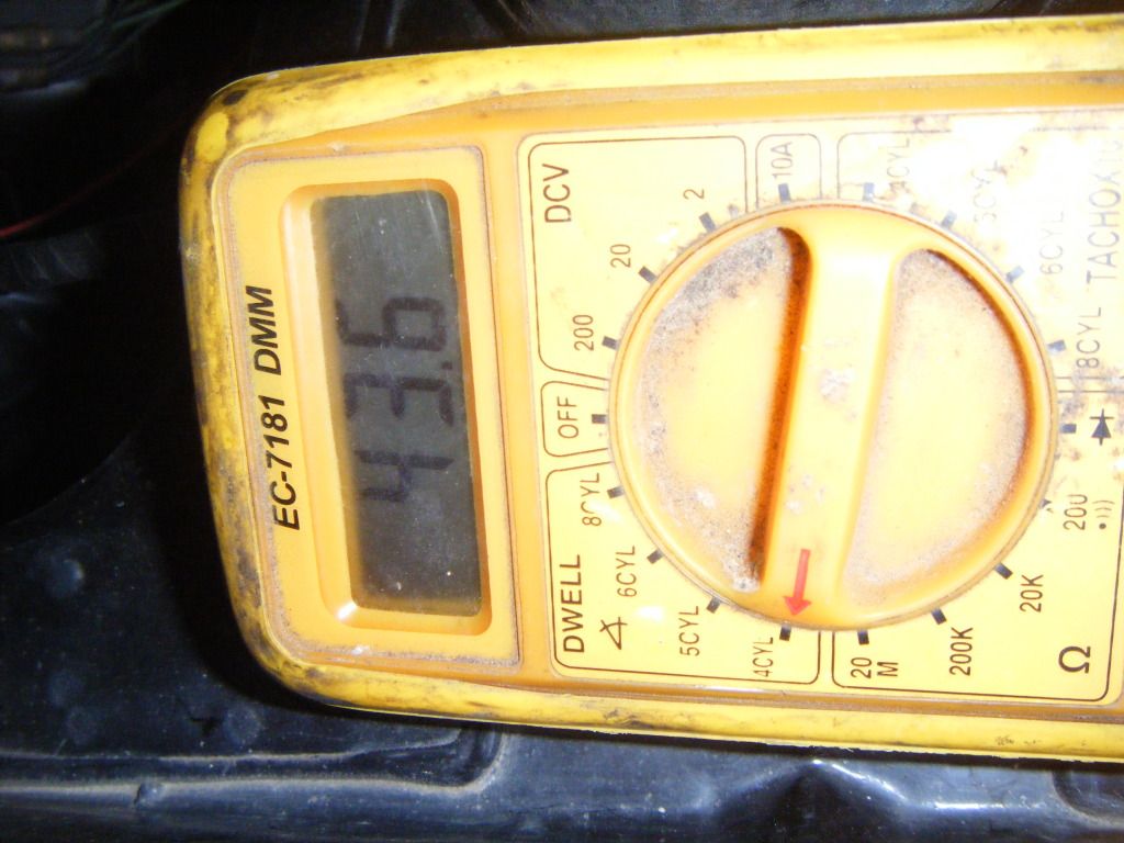

Okay so i've currently shut up shed but had it set at 0.016 but i didn't clean the feeler. Will pull apart and give it a wipe tomorrow.

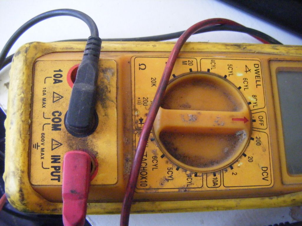

I've got a multimeter that seems to have a DWELL reader on it. what setting do i have it on?
- This one:
Video had 3 plugs so im guessing i have the wrong tool here???
I dont have any idea or tools to check timing. Are they costly from repco or something? Car seemed to run much better before it got put away.
- This one:

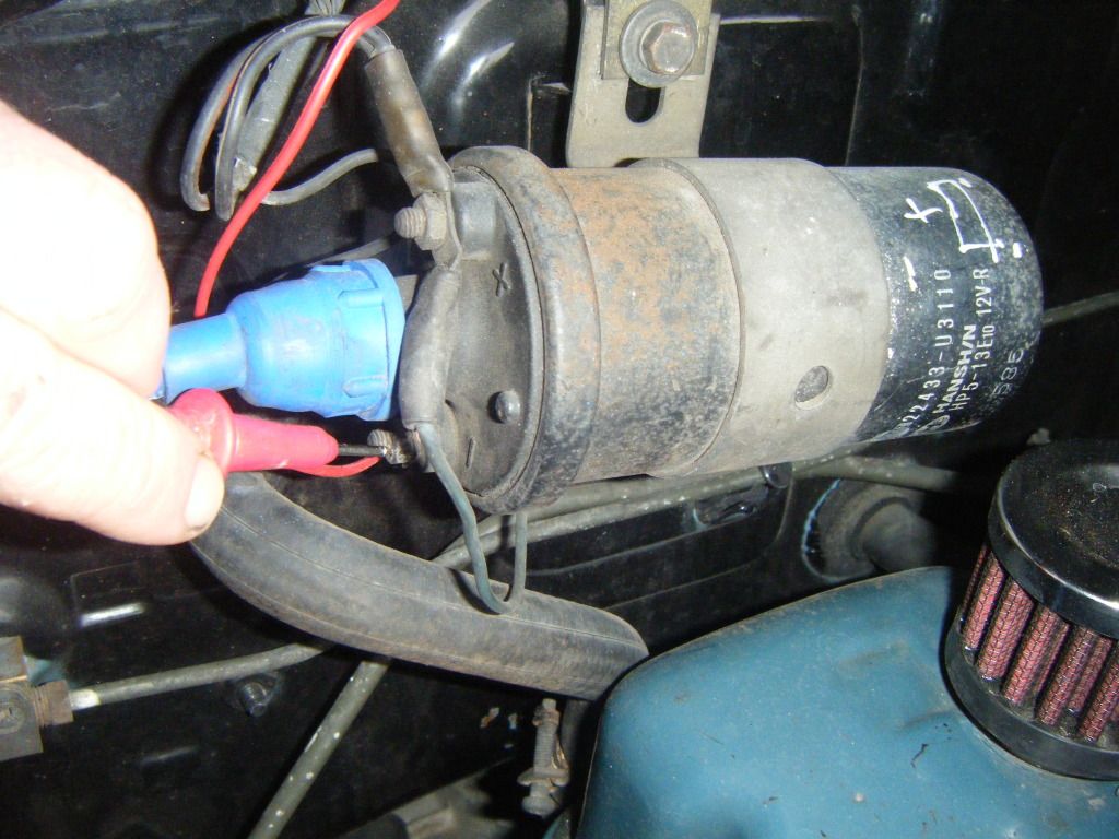

you only need 2 wires, that looks like it should work. Red to the coil -ve I think and Black to earth. If this doesn't work swap to +ve terminal of the coil.
Timing light is a good tool to have especially if you are going to maintain older cars. Supercheap have them pretty good, and with the card they can be even cheaper. Same quality as Repco, just cheaper. Paying a mechanic to set it will cost about the same as buying a light. But doesn't feel as good as doing it yourself.

Moved feeler to .02 and did the dwell test like this:
negative was to strut.
What do i do from here? move space at points out or in a little or wait untill i get a timing light?

sorted!!! You guys are BOSS!!!
Got DWELL up to 50 now.

Wee rule for adjusting dwell, "Larger the gap, smaller the dwell."
