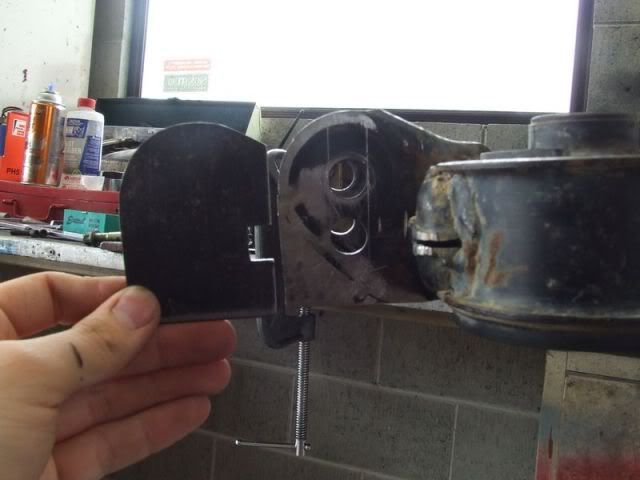

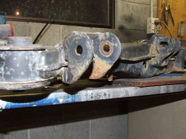

So it seems Odd I'm working on making the rear Camber Adjustable Before the front, but anyways ....lets crack on

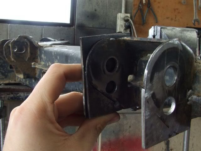

1x IRS Nissan Semi Trailing Arm Subframe for reference
Now were going to slot the holes a shitload to correct camber for lowered cars
The idea is for street driving you get it set to about 1deg neg, and for track days you can take the correction out IE when you drop your car and the rear camber skyrockets to like -2.5 you can add neg camber back in up to this amount.\

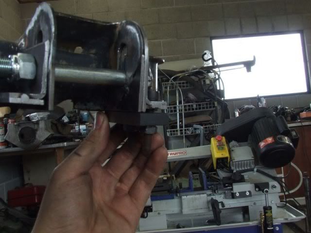

another view

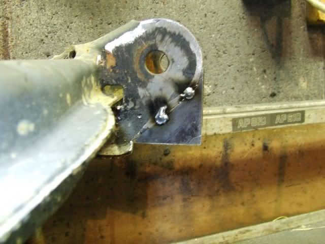

And the start of the adjuster plates, so far they are only 4mm thick but I am going to double skin them to give them some beef as they will need to hold a fair bit of tension. I will also gussest the sides
Here you get the idea that there will be a plate welded across the bottom ( 7mm flat ) with 2 holes drilled in it to match the adjuster bracket.
Its just the the chain adjustment on a motorbike.
Tomorow I need to file the bottom of extension pieces dead flat, and then I can tac weld the big plate that goes underneath that the adjuster bolts to.
I am doing all the work, however this will be tig welded by a guy who is friendly with the local Certifier 8-)

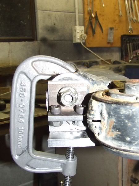

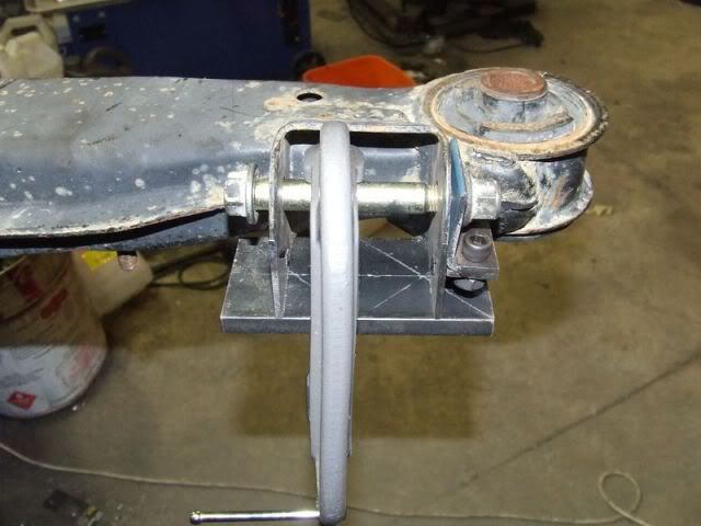

Been out and Spent HOURS hand filing the bottom of the extension pieces so that they are dead level, and also some more work on the adjustment brackets.
I found a nice big hunk of 10mm flat stock, but i might have this milled down to about 7mm as I can't see any reason for it to be that heavy.
So far its going well, Tomorow I will cut the slot down and figure out the max adjustment, and then drill the bottom plate

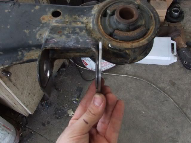

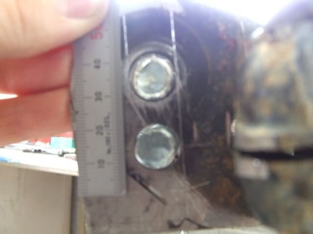

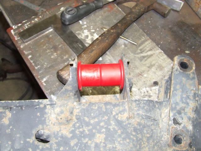

This side is getting close to being finished now,
First my spanky new poly bushings all the way from the USA
Top hole is original showing range of adjustment

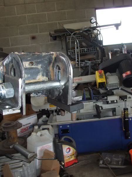

Paranoid about passing cert so i made reinforcement plates for each side
this one is not completed yet

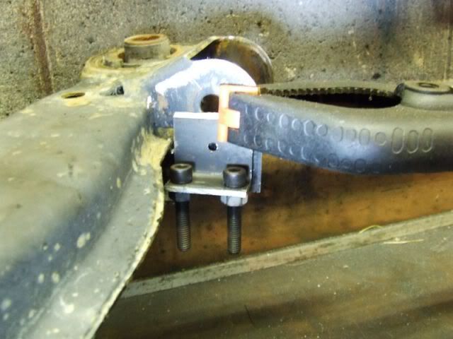

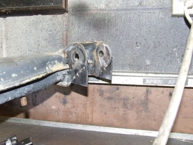

I am nearly finished on this side, so now you guys get to see what the final thing looks like
its bad ass to actually see it coming together. there are a few kits you can buy to do the same job
but they cost heaps and I think Mine looks better.
Before anybody asks I will not be doing this for anybody even for real money, takes SOOOOOO LONG to get it right
