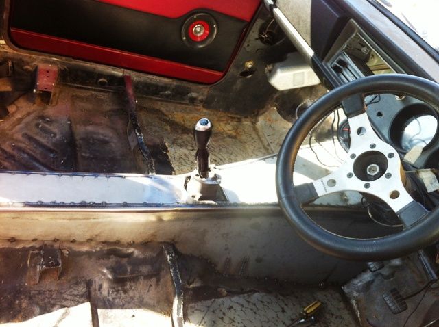

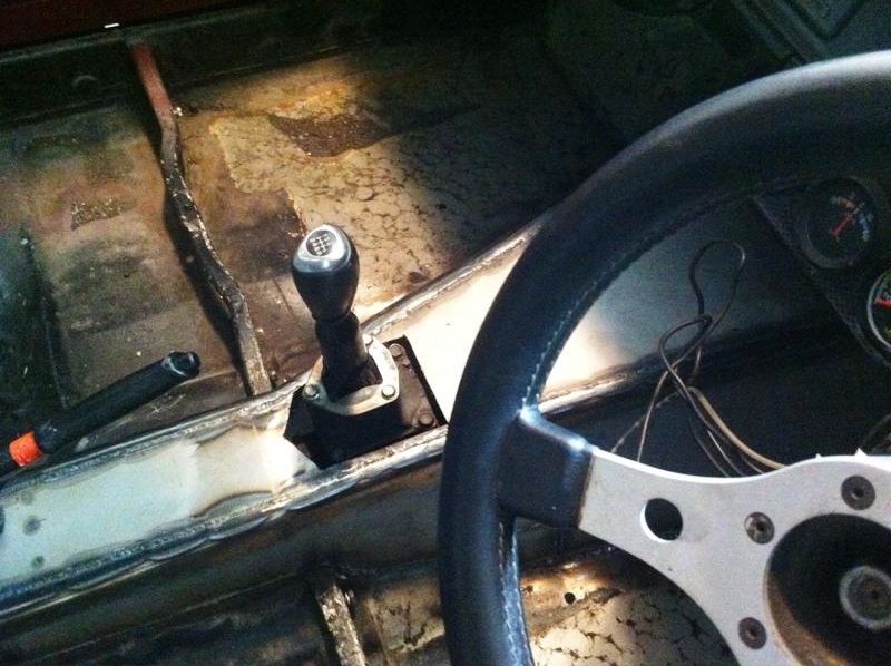

Slowly getting there,
Re: my sedan
just about done
Re: my sedan
Tunnel's all done. got the sedan back home now to get the drive shaft made up then can go back for exhaust.

Looking sweet man! Nice and tidy

That tunnel is very neat and tidy.
Re: my sedan
yeah very happy with the result. Any ideas on whats best to paint it with to keep it tidy?

Re: my sedan
POR15?
Or some two pack epoxy type paint?

Re: my sedan
A good quality epoxy primer followed by a nice direct gloss (2K) topcoat.
You can wet on wet the two for less sanding. If you're interested in this I can give you a step by step guide and product recommendation. From memory, Por15 is good but works best when applied over surface rust as it uses the rust conversion to create strong chemical adhesion
