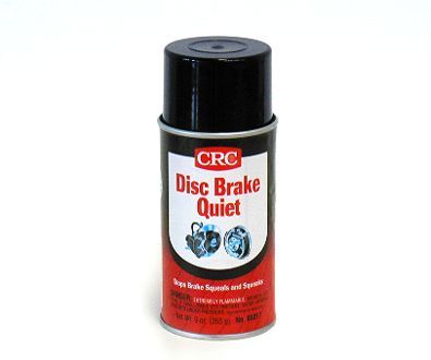

Yeap, the pads having a rubber backing on them when you buy them, there are no other shims. I've tried the CRC disc brake quiet:
One pad was stuck to the pistons when I took them apart to put the new pads in, the other was loose. The calipers are only made to take a 30mm wide rotor but I'm running 32mm GTR rotors in them, I don't know if the calipers are machined differently or different castings to take the wider rotors etc etc, nothing is touching that I can see, things were reasonably tight to get apart but once I'd pushed the pistons back everything went together reasonably loosely.
To me it sounds like the squeal is coming from the front, I've had them apart 4 or 5 times now and can't see anything wrong. The back pads definitely need replacing so I will try and do that over the next couple of days.

Wurth great product twice that of CRC.
Also Wurth Brake cleaner is mean

my1200 wrote:Wurth great product twice that of CRC.
I second that.
