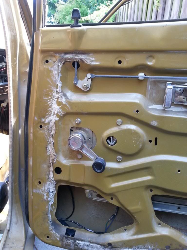

Got my new phone so can take photos again yay! Here's a pic of the drivers door with the central locking motor installed. For the rear doors I'm going to need a much longer arm to mount to that short locking arm on the door will most likely end up mounting the motors vertically and attach to the locking arm. Will hunt around work for some quite small o.d rod.

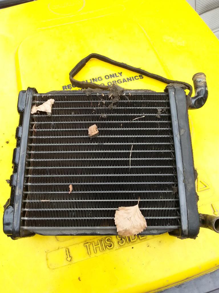

Also spent many hours trying to track down the leak in the heater system. First I attempted to try and remove the whole heater assembly which was proving difficult, I suspected it was the heater tap right at the back but after putting my hand in behind it was bone dry, so after much confusion as to where this leak was coming from I manage to figure out that the core itself was leaking Whipped that out and yup pretty nasty leak on the side, which is weird must've been on it's way out as it never leaked since I first topped the cooling system up... Because I'm a hoarder and don't throw things out I had a spare! Filled that up with water to see if this one was any good seemed legit so chucked in it hooked the heater back up voilà no more leaks!

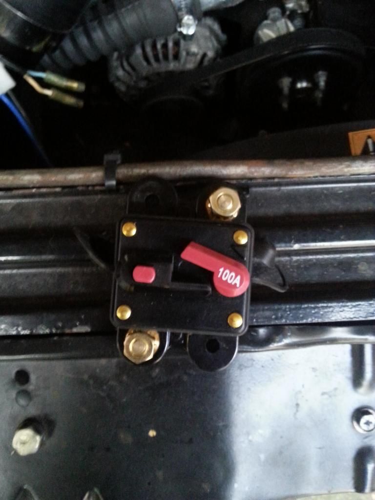

Did a little bit of work on this while I was waiting for the rust converter to dry, went to install the 100A circuit breaker I got a while ago to replace the factory fusable link that these have from factory. But the sheet metal screws wern't quite long enough so ended up being a fail. Will swap the ones I bought for longer ones and try again. Here's a pic of the circuit breaker.
