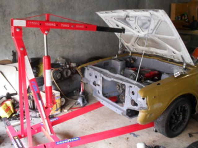

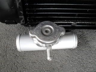

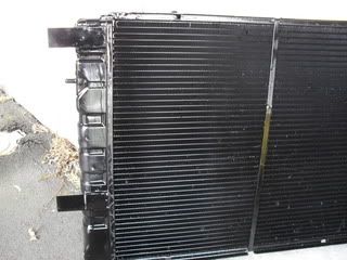

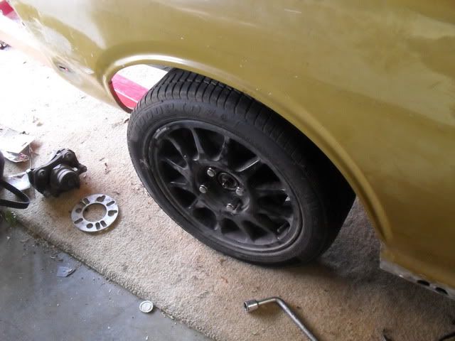

Today i finished greasing and assembling my rear axels, borrowed some factory Laurel mags off Bart which cleared the spring by having the brake rotors on to space them out a bit. Also got the crane in position to take the motor out when i get my stand back, which should be this week. Im going to have to jack the car up again so i can fit the legs from the crane under the car to get it a bit closer. Radiator as been modified had to go remote resovoir so the bonnet would sit nice and tabs have been welded on to make mounting easier. Might also need to go for longer springs in the front too so they stay captive.

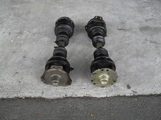

The cv's look swwweet, what diff are you running again?
Also really like those wheels in black.

Ill be running an R200 VLSD Martin. Just need to find and buy a lsd center for the diff.
